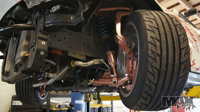

Tue Aug 20 2013, 08:13pm
Joined: Sun Jan 21 2007, 08:28pm
the prototype drop knuckle and FUCA.
Royal_T
Tue Aug 20 2013, 10:07pm
Registered Member #951
Joined: Sun Jan 23 2011, 08:21am
Posts: 63
FUCK that looks so bad ass.. Nice work guys..
Okay question are those PBM A-arms?
Also are you guys going to make any changes to the adjustable? So we don't have to remove everything to make changes? I know a lot of people are complaining about that.
Thanks guys
Tue Aug 20 2013, 10:27pm
Yes, its our FUCA prototype
you must take off the FUCA to adjust. we dont really care if its time consuming to adjust, there is no room for the double threaded adjuster there & you set it and leave it forever unless you change wheel width/offset
